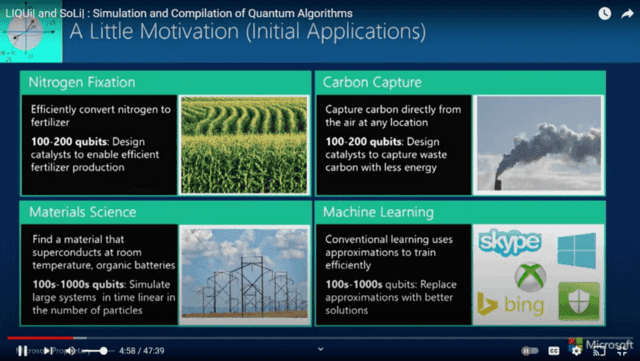

Why Is Quantum Computing Needed?
Conventional machines cannot complete certain computational tasks within any practical amount of time. Creating an efficient way to remove carbon from the atmosphere is one potential Earth-changing application for quantum computers.
quantum computing applications

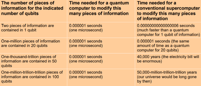

Like a coin, a qubit yields one of two values when measured, and combinations of qubits carry probabilities for each possible combination of measured values, with each possible combination called a basis state. Unlike coins, the probabilities associated with each basis state in a quantum computer are progressively modified by the user until measurement reveals a meaningful answer.
Zapping a single qubit, or even multiple qubits, takes approximately one microsecond. For small quantum computers this is currently faster than modifying comparable information on a conventional supercomputer, though as larger numbers of qubits become available, multiplexing and demultiplexing of the zapping waveforms will likely be needed. By contrast, a conventional supercomputer can take a long time to modify a comparable amount of probability information, as the following table illustrates.
Comparison of time required for a quantum computer versus a conventional supercomputer to modify equivalent amounts of probability information, based on a supercomputer speed of one exaflop (10^18 floating point operations per second)
number of qbits

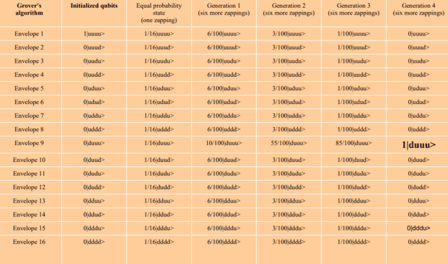

Grover’s algorithm is a quantum search algorithm. In this example, it searches through 16 envelopes, treated as basis states, where fifteen envelopes each contain a worthless small green piece of paper and one envelope contains a one-thousand-dollar bill.
The algorithm works by successively zapping four qubits so that the probability associated with one of the sixteen possible basis states becomes much larger than the other fifteen, with the highest-probability basis state corresponding to the envelope containing the prize. The two possible measured states for each qubit are written as |u> and |d>, so the sixteen basis states range from |uuuu> through |dddd>.
The table referenced below shows how the sixteen basis states of the four qubits change from the initialized state, through the equal-probability state, and then through four generations of basis state probability updates. By Generation 4, the probability for one basis state reaches 1, meaning every pass through the algorithm followed by measurement of the four qubits will yield the |duuu> basis state, identifying the envelope containing the money.
grovers algo

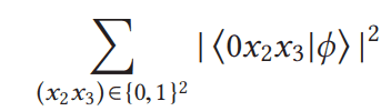

    I love the challenge to learn offered by this thread. Thank you [USER=89234]@Bob Walance[/USER] .
    I’m working my way carefully through Quantum Algorithm Implementations for Beginners linked in #2. I
    I’m stuck on the notation in equation 11, page 18:5. I presume that the summation is for all possible values of X2 and X3, but I don’t see how the notation says that.
    [ATTACH type=”full”]304332[/ATTACH]
