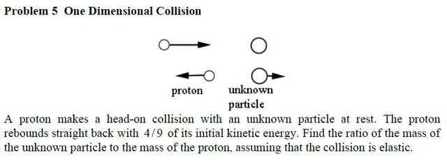

4. Collision of Atomic Particles
This example is a solution to Problem 5 of another MIT problem set (Problem Set 7: Fall 2012).
MIT One Dimensional Collision Problem
Let the mass of the proton be m and the mass of the unknown particle km with k>1. Since the unknown particle is initially at rest, its post-collision momentum will be the same as the collision impulse so we can easily calculate an expression for its kinetic energy and compare with 5/9 the kinetic energy of the proton.
For an elastic collision: $$\Delta P=2\mu\Delta v = 2 \frac{km^2}{m(k+1)} \Delta v = 2\frac{k}{k+1}m\Delta v$$ Post collision kinetic energy of the unknown particle will be ##{\Delta P}^2/(2km)## $$\frac{4k^2m^2{\Delta v}^2}{2km(k+1)^2}=5/9 \times ½m{\Delta v}^2 $$ $$\frac{2k}{(k+1)^2}=\frac{5}{18}$$ $$36k=5k^2+10k+5$$ $$⇒(5k-1)(k-5)=0$$Hence since k>1 we determine k=5.

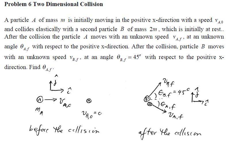

    Not restricted by anything different from conservation of momentum and conservation of energy. Will prepare an example shortly but thanks for the comment all the same. Prompts a bit of work on my part!
    You might like to try Problem 6 from the same MIT Collisions Problem set as Problem 5 above. (PS: if anyone from MIT views this, please advise on how I should reference this particular problem set which I downloaded some time ago but can no longer find online. It’s Problem Set 7 dated Fall 2012).
    [ATTACH type=”full”]257491[/ATTACH]
    As before I’ll eventually get round to adding this as another worked example using the alternate method.

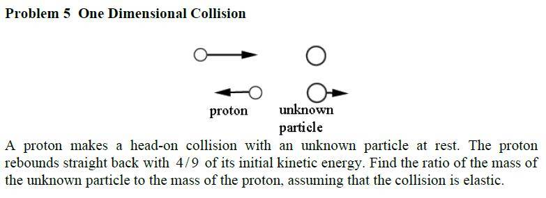

    You might like to try the following from an MIT problem set (Physics 8.01 Fall 2012).
    [ATTACH type=”full” alt=”MIT Problem 5.jpg”]257268[/ATTACH]
    20th Feb 2020: Added above problem as another worked example in the article.
