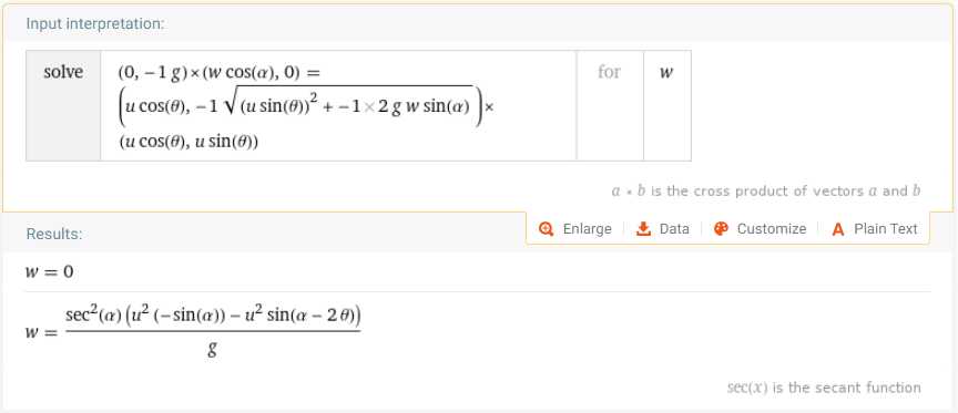

Worked Example 2: Range up a Slope
This will be a symbolic problem whereby we derive an equation for the range w of a projectile fired up a slope of angle ##\alpha## at a velocity v and angle ##\theta## from the horizontal (clearly ##\theta>\alpha##). Preparing our entries for submitting and solving the vector equation on Wolfram Alpha, we write:
$$\vec{g}=(0,-g)$$ $$\vec{R}=(w\cos\alpha,0)$$ $$\vec{u}=(u\cos\theta,u\sin\theta).$$Once again the horizontal component of velocity ##u_x=v_x=u\cos\theta## does not change but we will need equation 6 to obtain an expression for ##v_y##.  For this we write the vertical height gained by the projectile as ##w\sin\alpha##. Then: $$v_y=-\sqrt{((u\sin\theta)^2-2gw\sin\alpha)}$$. Hence the overall vector entry for ##\vec{v}## will be: $$\vec{v}=\left(u\cos\theta,-\sqrt{((u\sin\theta)^2-2gw\sin\alpha)}\right).$$We may now proceed with submission of the vector equation on Wolfram Alpha.
At first glance, the solution appears to be all negative, but the term ##-u^2\sin(\alpha-2\theta)## can be written as ##+u^2\sin(2\theta-\alpha)## and the reader may verify this as the correct expression for a range up a slope here.
It is true that Wolfram Alpha “chomps” through a lot of algebra to reach the above solution but if the reader cares to examine the ‘step-by-step’ solution, it will be clear that there is nothing particularly complicated about the process. Wolfram Alpha simply assures us that there won’t be any mistakes in the algebra leading to the range equation above. And that we can have every confidence in employing the vector equation as indicated since the results are the same as those obtained by more ‘conventional’ means.
It is worth noting that the determination of the range down a slope (rather than up) entails nothing more than a single sign change in the above vector equation:
