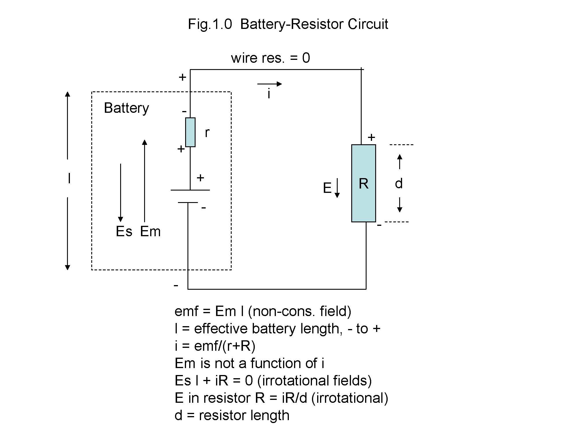

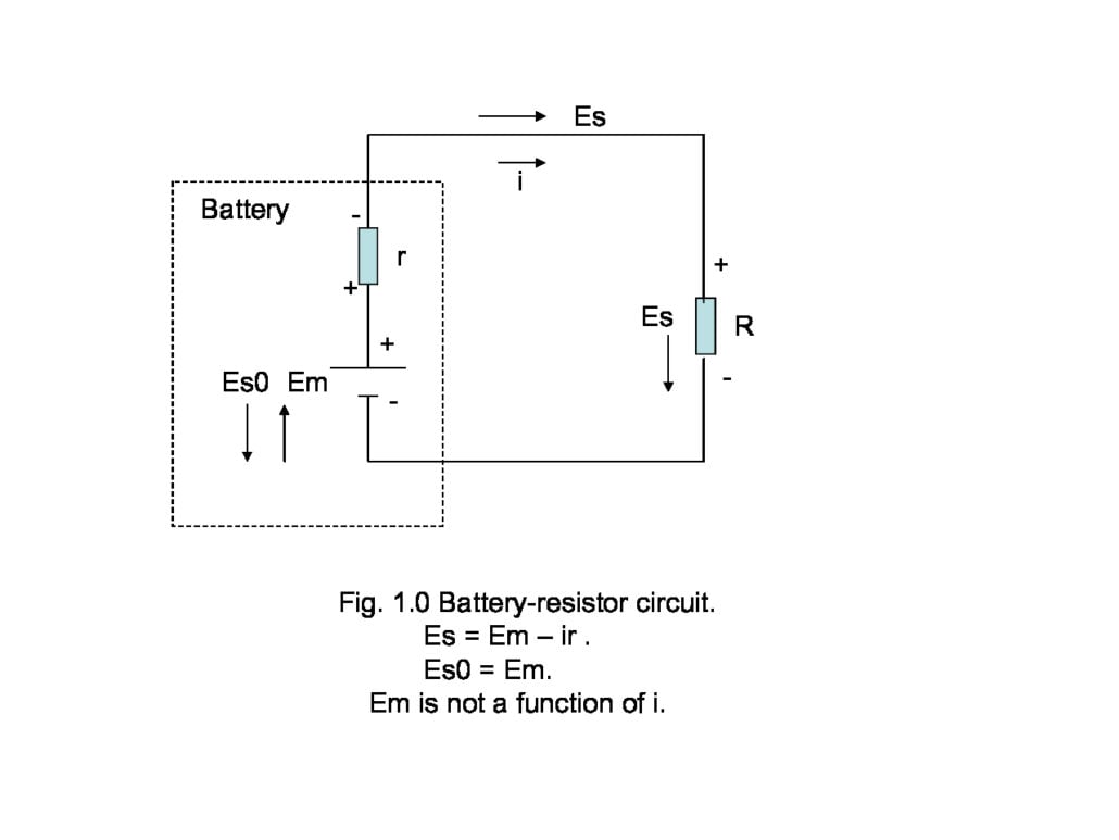

Battery example
The first and admittedly controversial example is that of a chemical battery.  It’s controversial because most folks consider that there is only one E field in the battery, pointing + to -, which corresponds to my Es.
There is in fact also an Em field inside the battery, pointing – to +-.  This Em field, line-integrated over the effective length l of the battery, = emf.
In the absence of current draw these two E fields are of equal magnitude so the net E field is zero.  But with current i, internal battery resistance r and external resistor R the Es field is reduced to ## Es =  (emf – ir)/l,  i = emf/(R+r)  ##. ## \oint \bf E \cdot \bf dl = \oint \bf Em \cdot \bf dl = emf ##; ## \oint \bf Es \cdot \bf dl = 0 ##.

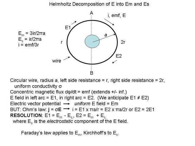

Faraday ring (asymmetric resistance)
Next, let us look at a conductive ring of asymmetric resistance around the ring surrounding a time-varying B field (Fig. 1.1, the “Farady setup”). We get both Em and Es fields in the ring due to the differing resistances in the two ring halves.
The electric vector potential clearly indicates that the induced E field is uniform around the entire ring.  This goes beyond Faraday who simply says that the circulation of the E field around the ring is the emf  .Thus, any E field present in the ring other than the induced field (Em) must by Helmholtz be a conservative field (Es).
The circulation of Em = emf = ## -d\phi/dt ## per Faraday, while the circulation of Es = 0 around the ring per Kirchhoff.
The voltage from top (+) to bottom (-) of the ring is ## \int_A^B \bf Es \cdot \bf dl = ir/2 ## in either direction and can be measured by a voltmeter provided the normal to the plane of the meter’s leads and body are orthogonal to the B field, i.e. suspended directly above the B field source.  Any other juxtaposition will give an erroneous voltage reading.
Note that the Em field is that set up by the ## d\phi/dt ## field in vacuo and is not altered with the insertion of the resistive ring.  The asymmetric ring produces new Es fields only.

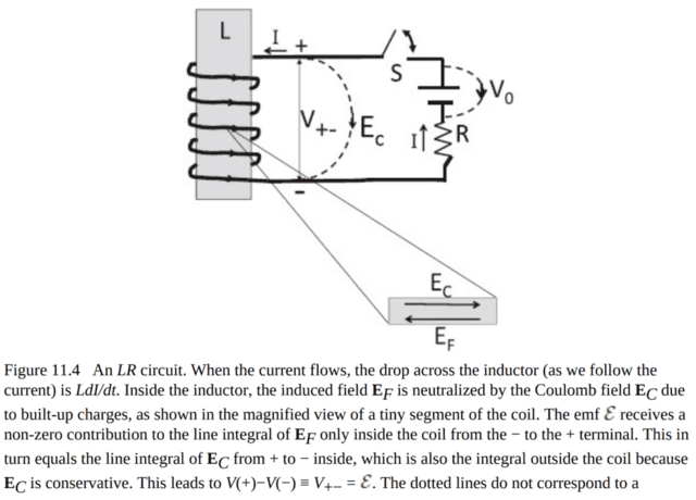

Inductor (solenoid) example
Let us look at a third example of emf generation (Fig. 1.2 below).
L is an inductor wound of zero-resistance wire in a circuit with a battery and resistor.  Current I will flow when switch S is closed. (Fig. 1.2).
Source: Fundamentals of Physics II, R. Shankar
                              Fig. 1.2 Inductor E fields
(https://en.wikipedia.org/wiki/Ramamurti_Shankar for his CV).
Per the figure we identify two E fields inside the wire: a non-conservative ## \bf E_f ## and an irrotational ## \bf E_c ##.  (Shankar’s ## \bf E_f ## is my ## \bf Em ## & his ## \bf E_c ## is my ## \bf Es).  ##
If we integrate the E field over the solenoid’s wire, closing the loop from the bottom end of the solenoid, thru the wire and back to the bottom end (path ##E_c##) we obtain ## \oint \mathbf E_f = L dI/dt. ##. whereas ## \oint \bf E_c = 0 ## (zero-resistance wire assumed).
R. Feynman covers the same issue in Vol. II chapt.22 of his famous Lectures and gets the same answer but his rationale is wrong because, by ignoring split fields he implicitly denies ## \oint \bf E \cdot \bf dl = -\partial \phi/\partial t ## for the circular E field inside the wire, stating simply that the E  field is identically zero.  In reality two equal and opposite E fields, Em and Es, cancel each other.  Letting E = Em satisfies the above equation.
We can, analogously to the battery with finite internal resistance, cover the case where coil wire resistance r is finite.  Es is similarly reduced to Em – ir/l, l = coill wire length, and the coil voltage reduces to V = L di/dt – ir.
 The solenoid is the exact analog of the battery: both create emf, one chemically and one magnetically.  Both hold equal and opposite Em and Es fields. Both hold net zero E fields.

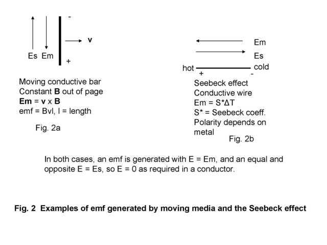

Moving conductor in a magnetic field
Next example: that of a conducting bar of length l moving orthogonally within a constant B field with constant velocity v (Fig. 2a).  Imagine you are sitting on the bar; you have no idea you’re “moving”, yet an emf = Bvl is generated, Simultaneously, an equal and opposite E field must also be present; the net E field in the bar must be zero.  This must be the electrostatic field Es.  A voltmeter configured so its leads are not impacted by the B field would read the integrated Es field, numerically the emf.
EMF generated by moving media and seebeck effectLast example, and perhaps the most basic: the Seebeck effect (Fig. 2b).  In this case the emf is generated by a temperature difference between ends of a wire.  Good choices would be iron or constantan.  Again, the wire must have zero E field within it yet an emf is generated and can be measured with a voltmeter, this time without any concern as to meter circuit disposition. Separate equal and opposite Em and Es fields are again the only cogent theory.
Seebeck effect (thermoelectric)
https://en.wikipedia.org/wiki/Thermoelectric_effect#Seebeck_effect
We see that in all examples there is curl.  By Stokes, whenever the circulation of an E field is non-zero there must be net curl within the peripheral area bounded by the circulation path. Curl may also be in the E field itself as in the inductor.  In general, all sources of emf have associated non-conservative fields with curl somewhere.

    An excellent & detailed description of electric fields in a chemical battery is at https://www.av8n.com/physics/battery.htm#fig-battery-rest-field
    Fig.5 shows the Es and Em fields canceling each other to give a net zero internal field, while the + to – line-integrated internal (or external) Es field is the emf. The two Es fields’ circulation is zero as required for an electrostatic field..
    In fig. 7 current is flowing and the internal Es field is reduced by the internal resistance by an amount ir with r the internal resistance and i the current. As a consequence the Em field provides a net battery internal E field with direction from – to +.
